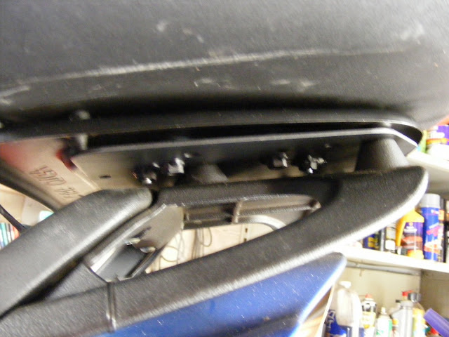

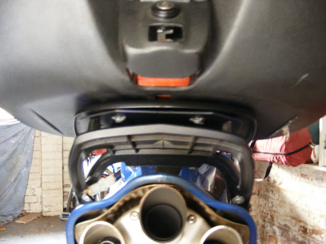

Aftermarket top box installation on Sprint 1050
What you need is a 3mm thick adaptor plate between the Triumph rack and the top box mounting plate.
I welded some M6 nuts to the adaptor plate for ease of installation and removal.
I also have two positions for the top box. A forward position for solo riding and rearward for 2 up riding. The forward position improves handling by bringing weight forward 100mm and reduces the cantilever effect operating on the rear subframe which has been known to fatigue crack.
The adaptor plate now looks like Swiss cheese but does the job.
Here are the pics
