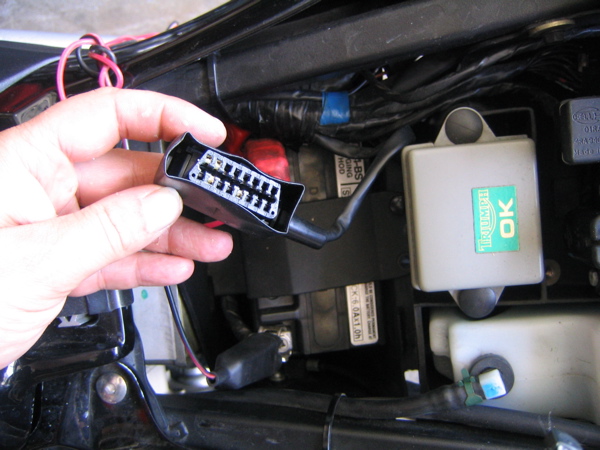

Could this have anything to do with it? Have no idea where this plug goes.. found it loose next to the battery... yikes.. Don't see anything that it should plug into.. going to browse thru my manual now I guess..
Yikes, could it be the Triumph Service Diagnostic Tool multiplug? Yies, I bet it is. :-D

Thanks. That is the diagnostic plug. Just found it on the wiring diagram of my manual. How do I use a Voltmeter (I'm presuming thats what you mean by VOM) to check the starter switch? I pulled the two wires that go into the switch and cleaned their connections. Seems to work a bit better but its really intermitant.
