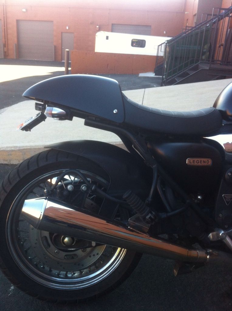

Yeah it's from the earlier Daytona 900 triple. I picked it up on ebay for $20, there should be a few more. I forget what year it was from, but if you get it, make sure its the style that has the chain guard. It bolts right up to our swing arms. I had to shave a little bit off of the side that bolts down on the brake side, where the bracket support bolts to the swing arm (you have to drill and tap a hole for that side), but other than that, everything else lines up perfectly.
Here's a better pic of it all together. I also have a Thruxton seat and cowl on as well.
How did you mount the cowl onto the bike? Did it go on pretty easy?

looks great 303 frost i like the style of your bike and the hugger goes well would you not be better putting bungs in the ends of the frame or maybe you have and you just dont notice it but good job .
Mutt
That cowl and seat is from a Thruxton. I just went to a triumph dealer and bought one. You can get any of the newer Bonneville seats to fit our bikes, and as you can see, it follows the lines of the frame quite nicely. All I had to do to mount the seat was buy a seat latch from any of the triples that have that system, and bolt that onto the seat, and make a little bracket for the seat tongue by the tank. I also had to bend in the seat hooks towards each other a little bit because they have a wider stance than our seats do. I think that seat is much more comfortable than the tbird/legend seats, and It's nice having a brand new out of the box seat.
Do you have any pics? I'm not sure what you meant by "little bracket'.
