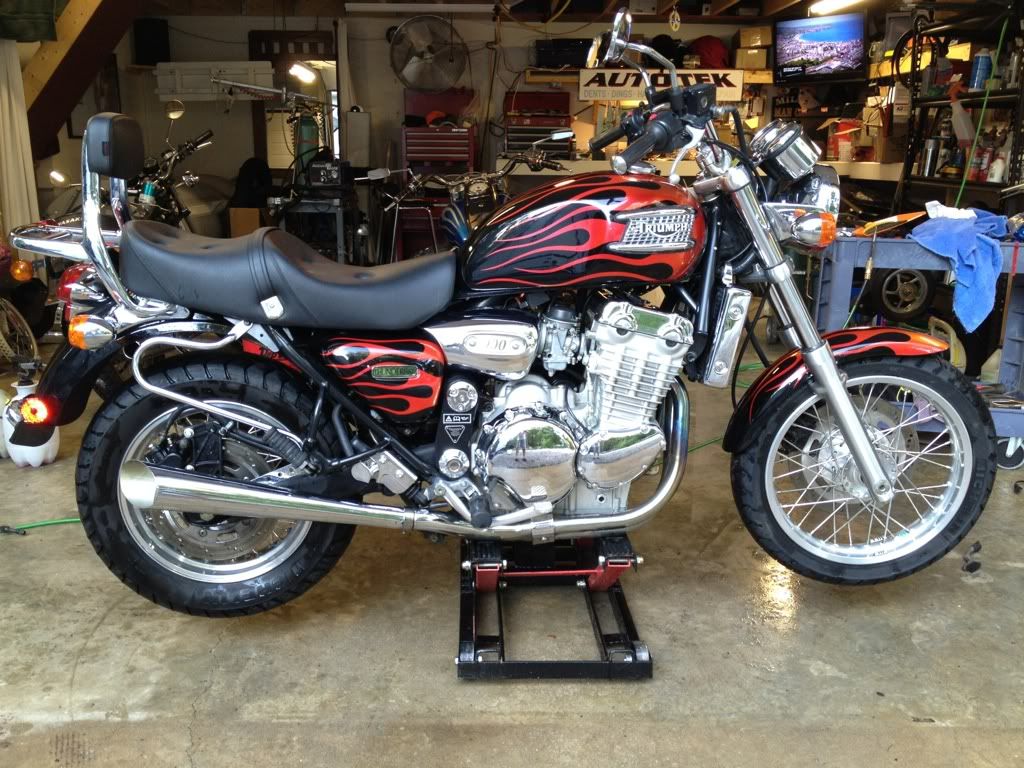

I bought this bike about a year ago and have left it in storage. Its a low mileage (8600) bike in what appears to be showroom condition, 1997 Thunderbird 900 Triple. I cleaned the carbs yesterday and found a few obvious flags so I expected a good running bike today when I got it back together. It starts easily and runs very smooth on the stand but when I drove it, it begins to studder at around 4500 rpms, almost as if it is being rev limited. Not matter what gear it is smooth until about 4500-5000. Does this bike have a low oil limiter or something? It is difficult to see through the site glass so im not sure if it is low or perhaps high and I dont want to overfill it. Has anyone had this problem or know where I should go next. Obviously I plan to drop the oil and add the recommended amount with a new filter very soon.
FYI= the carbs are clean and sinked and the air jets are at 2 turns out from bottom. (an average of where they started) Thanks for any help. Milo
