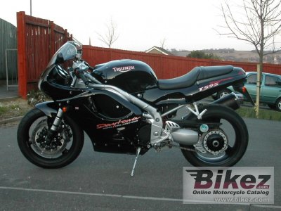

Not sure how you mounted the stock classic fender, Faffi, because the forks are entirely different in terms of fender mounting points:
'93:
Even more so for a '97:
The stock fender would not work from a classic, without coming up with a different mounting method. Of course, anything can be done!

Kinda suspected that, Faffi. Looks like it required so mods to retain the "correct" look. Nice job!
