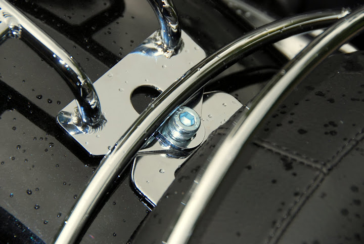

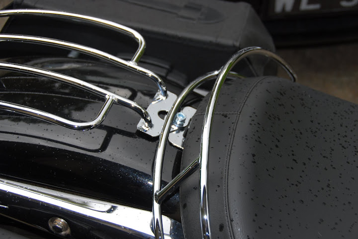

Ok fixed it. As antman suggested, went to local hardware store and purchased a suitable M8 bolt with Alan key. Looks just like this:-
