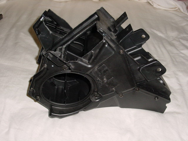

If your interested I have a pre-carved up air box for sale...
Figure $25 for the air box plus freight...
