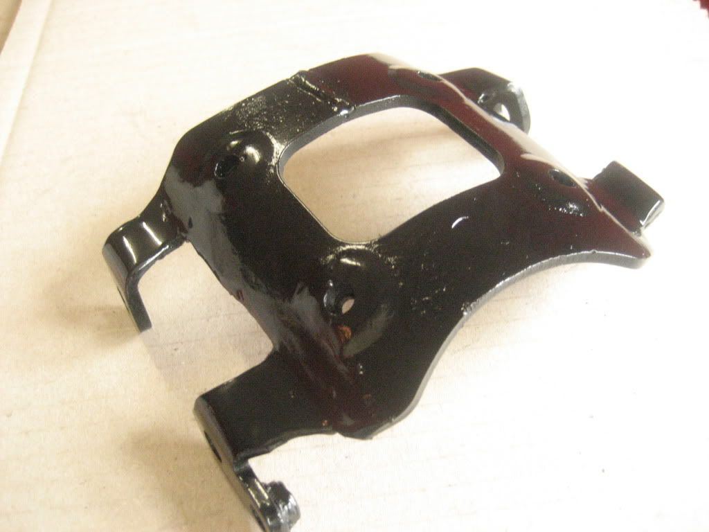

G'day everyone,
I'm currently lowering my front guard (fender) which means modifying the mounting bracket, my question is how close to the front tyre would be safe with this bracket in regards to tyre deflection, if any? I'm thinking of getting it within 3-5mm would this be to close?

Interested to hear the progress on this mod.
I have a Sport Demon 110/80/18 front tyre with the stock fender, bracket and bolts. It seems as though the tyre has touched the bolts at some stage, because there is a very slight groove in my tyre on the right hand side.

The fender would look great if it was closer to the tyre.
This is how it could look...
http://www.facebook.com/photo.php?fb...type=3&theater

Spot on Matress, that's the look i'm trying to achieve.
That seems strange how you got a groove in your tyre with the original guard, I have the sport demons 100/90/18 and don't think they ever came close to the bracket.

I think i'm gunna try this and modify the bracket anyway i'll just take it easy for a little bit in the twisties and see how it goes. I'll keep you posted on the results.

Matress quick update,
modified the bracket which was a little tricky but the end result was worth the mucking around. Have had it on the road for a couple of days and feel totally confident I'll give it a good test around the Great Ocean Road on Sunday.

Oh wow. That looks so much better! It looks like you had to cut it and weld it?
Were you down the Great Ocean Road a few Fridays ago? I went past a black Thruxton on my way to Lorne going through Anglesea.
