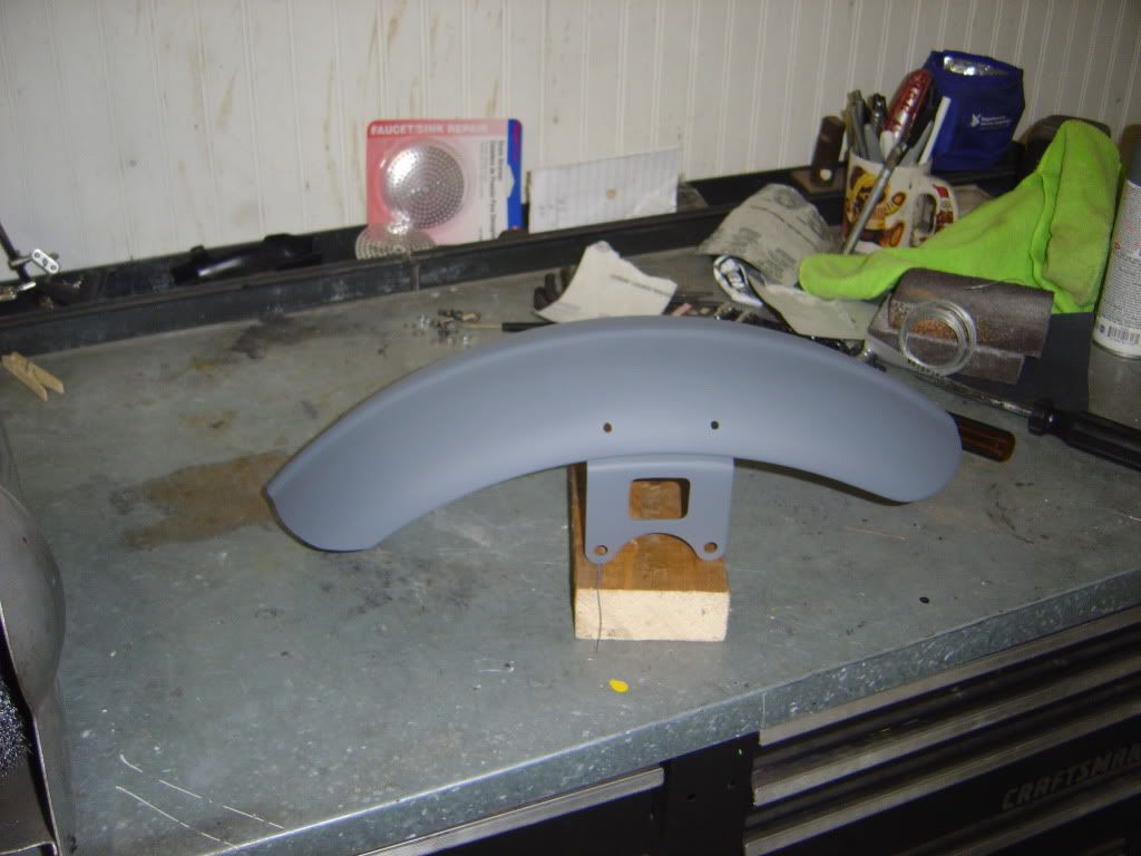

Hi everyone,
Last Friday night, I was alone, except for a bottle of cheap Shiraz. I thought it would be a good idea to start hacking up the stock Thruxton fender that was living beneath my bedside table.
I had most of the tools I needed...
- a hacksaw (blunt)
- electrical tape
- a rusty file
- a sanding block
I marked out the rough shape of the cut I wanted to make on one end of the fender. I then took to it with the hacksaw and cut to the line of the tape.
Once cut all the way through, I taped the off cut to the other end of the fender and marked a line to match its size and length.
Both cut ends ended up being fairly dissimilar from one another in terms of shape, so I took to them with a file, so that I could reshape them, measuring and re-taping the lines so I could check the shape as I went. After a bit of a filing and inhalation of powdered plastic, I had the shape I was after.
I then used a medium/fine sanding block and smoothed out the edges ready for paint.
I took the fender to the local paint shop and matched a tinned paint colour to the colour of the fender. I bought a small paint brush and touched up the edges of the fender and left it to dry.
And now, after spending $11 on a tin of paint, a brush and a new sanding block after I lost my old one, I have a newly chopped fender!
Mat

Nice! Been meaning to do the same thing. Didn't cross my mind that I'd only need to paint the edges.

I did the front on my TBS at the same time I bobbed the rear. It worked out great just moving the fender bracket up to aline with the last hole forward. I then filled in the hole no longer used and took a couple of inches off of the back.

It looks really nice and, in my opinion, much better than with no fender. Plus, the bracket functions as a fender brace - couldn't tell from the photos if you used it w/o the fender. In any event - great-looking modification!
I've never been crazy about the looks of mine, but am too lazy to keep things clean and have even considered a Fenda Extender or skid late to cut down on the dirt. Unfortunately - neither an improvement looks-wise.
