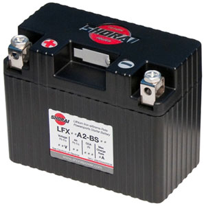

Shorai LFX DONE

If you go to Shorai website, note that year,make, etc will bring you to an LFX09L2-BS12
The 'L2' designation is the wrong orientation for the terminals on a positive earth setup.
The correct designation is LFX-A2.
The '09' refers to amp-hours, which is correct for my '78 Bonnie.
Some don't mind re-wiring for this glitch.
Hello Brien,
It is certainly possible to order this battery with the opposite terminals. For reverse terminals you will need the LFX09A2-BS12
Sincerely,
Aaron Jackson-Wilde
Shorai Inc.
My bike was originally wired so that the headlight could be switched on without the key, as long as the battery was connected, not the best setup for someone to accidentally (or on purpose) to drain the battery.
It's now wired so that it only lights with the key on.
