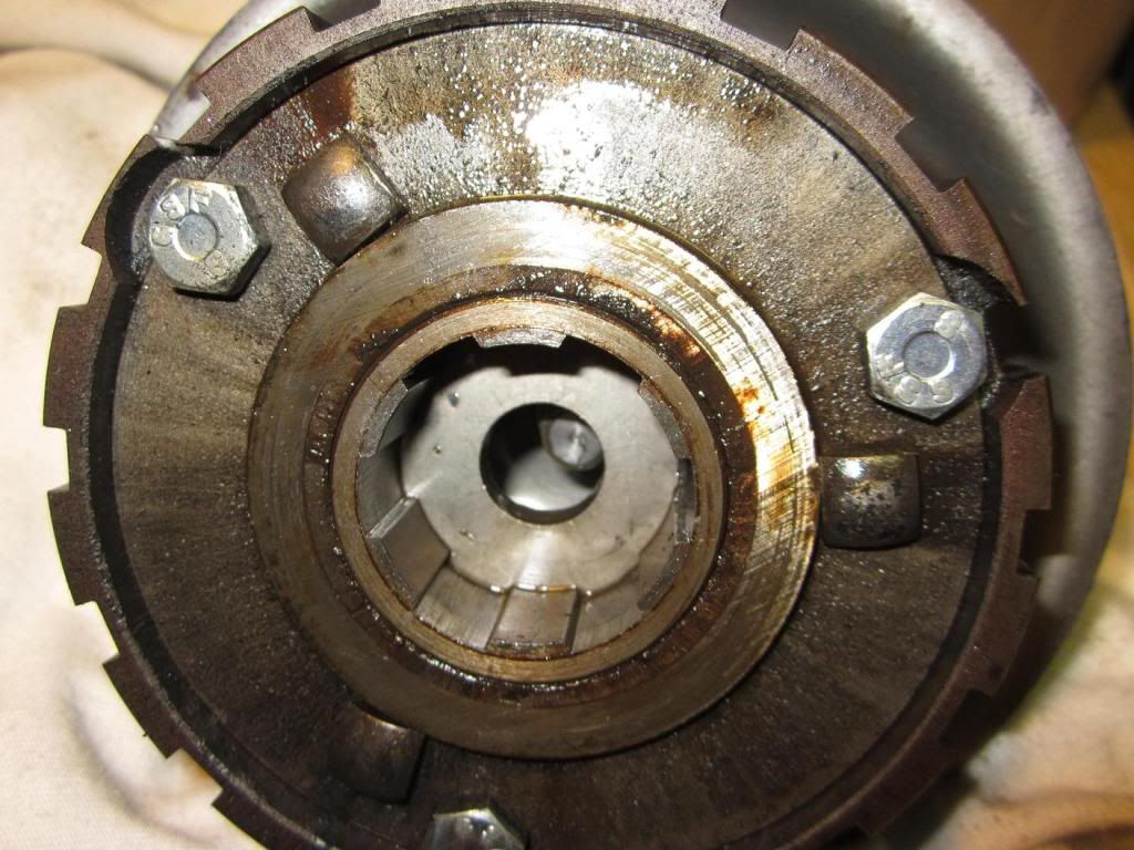

Everything was smooth sailing until then. I got the clutch' nut out no problem. But the washer below will not budge. I tried penetrating oil, tapping it around with a bolt, tapping the basket, making a dent in the washer to try rotating it a bit with a blow from a sharp screwdriver, more oil, trying to push the basket out with a crowbar ( be cool, I didn't use brute force here ! ). Nothing works. There is a bit a space on the outside of the washer, but NONE on the inside. It almost look like the washer wrapped itself around the center bolt threads. It is maddening. Why would Triumph make a washer so freaking tight in the first place ??????

Thanks guys but that didn't work. I guess that stupid washer has wedged itself into the bolt's threads, and it will keep the clutch basket from coming out. I tried again to drill a hole in the washer, but after wearing three new bits and barely making a dent, I gave up.

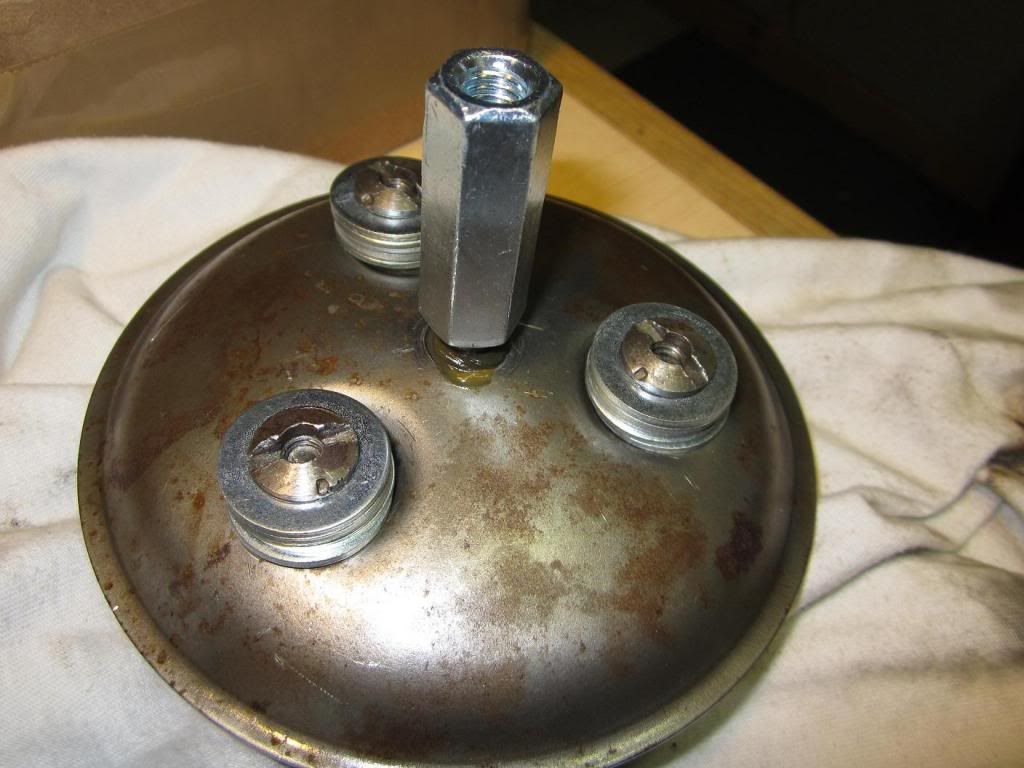

At last ! I got it !
Man, was I getting frustrated. I don't loose my cool, but the level of swearing goes way up !!!!
Anyhow, I tried all you guys' suggestions ( thanks for them ) but nothing seemed to work. I even tried to epoxy a socket to the washer....but that lasted about 1/4 second before it failed.
I decided to try a variation on Mr. Pete's idea with the clutch's cover. But instead of using the rod and the clutch cable to push the basket out, I put a bolt into the clutch shaft, bolted the cover to the 3 spring bolts without the springs with a pile of washers and used a good strong bolt setup in the center hole to push against the clutch shaft.
It worked perfect and the basket popped out...with the stupid washer still in place. Now I can drive it out from the inside.
Thank you all, especially Mr. Pete.
So relieved, it hurts !
Terry
