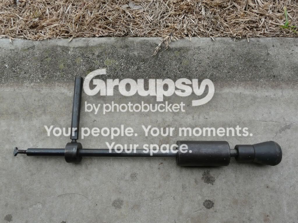

Hi Caulky,
I have removed this seal without removing the shaft using a specially adapted head on an impact puller (one of my home made Triumph tools).
If I get the chance today, I'll photograph the end piece to give some idea of its shape.
RR

Seal puller
As promised: This modified end will squeeze between the shaft and seal, and grips the substance of the seal from the inside.
"Necessity, the mother of all invention"
RR
