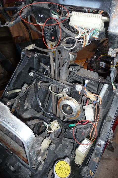

Put a new battery in hoping it would fix the nonfunctioning flashers. No dice. Anyone have an idea which is the flasher in this pic? Honda wants $33 for one and I would rather find a cheaper replacement if possible.
If it is a 12 volt go to Auto Zone and buy a $6.00 car one and see if that works. It's a scooter remember? By the way, duct taping a crate on a scoot is the first step in "Errands" running. Sorry.
It's 12 volt. I just want to take it with me when I go to the store but I'm not sure where it is. Are they all the same as far as connections? I don't know. I'm not really a mechanic, I just play one on the forums.

It will be the device connected to the turn signal wires.

Yep, it WAS the one connected to the signal wires...go figure. I have flashers, ready to reassemble the body parts now (no easy feat).
